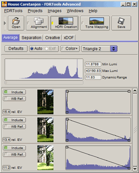

HDR method Average
Average calculates the HDR image as a weighted sum of the source images. This is simple and works automatically but has the disadvantage of creating so called 'ghosts' with moving objects. Ghosts are e.g. persons moving through the scene and showing up in several photos. When mixing the photos these persons then also show up several times in the resulting HDR image. Not all moving objects yield visible ghost artefacts. Scenes with moving clouds or water are normally noncritical as the ghost artefacts do not catch the viewer's eye.
The Average dialog
Controls and buttons impacting all images are located in the upper part of the dialog:
Button 'Defaults'
Resets all parameters to their default values.
Switch 'Exposure info'
Average needs to know about the exposure of the source images. With setting "Auto" the relative exposure values of the source images are calculated from the pixel data of the source images. With setting "Exif" the exposure value is extracted from the image EXIF data, provided embedded EXIF data is available.
Switch 'Color+'
Activating this switch can vitalise colors with nonlinear images like JPEGs. Color+ has no effect with linear images like RAWs.
Menu 'Weighting curves'
The menu allows to assign preset weighting curves to the image layers. These curves are meaningful with nonlinear images like JPEGs. The form of the weighting curve impacts colors and contrast of the resulting HDR image. According to present experience 'Triangle 2' yields best results and hence is the default curve. With linear images (e.g. RAWs) colors and contrast do not depend on the form of the weighting curves.
Below these controls there is a histogram display. The histogram displays the intensity spectrum of the resulting HDR image. To the right are the measured values for minimal and maximal luminance. Below is the image dynamic range in EV units, calculated from minimal and maximal luminance. Note: the stated dynamic range value is an estimation, calculated from the pixels of the Navigator image.
Below the histogram display the source images are listed as layers. The following parameters steer the influence of a layer on the result:
Switch 'Include'
When activated (green) the layer is included in the calculation of the result, otherwise the layer is ignored.
Switch 'WA Ref.'
Specifies a white balance reference image. When specifying an image as white balance reference the program tries to adapt the white balance of the other images to the white balance of the reference image.
Weighting curve 'Intensity'
Weighting of the intensity is adjustable per layer. The form of the curve can be adapted by adding/removing and moving knots.
Hint: modification of a weighting curve can be synchronised among layers. To do this select the layers to synchronise and then modify the curve of one of the selected layers.
rel. EV
The relative exposure value of an image is displayed here as an information.

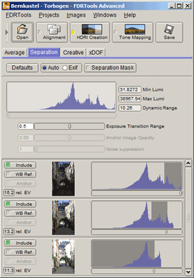

HDR method Separation
Separation - unlike the Average method - does not mix the pixels of the source images. Instead the image is assembled from several intensity ranges. Each source image contributes one intensity range. All resulting pixels within this intensity range emanate from the respective source image - an exception to this rule is the exposure transition range, see below. Separating the intensity areas allows to suppress 'ghosts' in scenes with moving onjects in a simple yet often successful manner. Further it allows optimal suppression of noise. Both aspects are described in more detail below.
The Separation dialog
Button 'Defaults'
Average needs to know about the exposure of the source images. With setting "Auto" the relative exposure values of the source images are calculated from the pixel data of the source images. With setting "Exif" (available only with RAW images) the exposure value is extracted from the Exif data.
Switch 'Separation mask'
Highlights the intensity areas of the selected layers that contribute to the HDR image, see example below.
Slider 'Exposure Transition Range'
If visible seams should show up along the separation boundaries then this switch allows to specify an intensity area where pixels are blended.
Slider 'Anchor Image Opacity'
not yet implemented correct.
Regler 'Noise suppression'
Below these sliders the source images are listed as layers. The following parameters steer the influence of a layer on the result:
Switch 'Include'
Switch 'WA Ref.'
Switch 'Anchor'
rel. EV
Slider 'Separation'
The slider is below the histogram and - in conjunction with the slider of the following layer - specifies the intensity area that this image contributes to the HDR image. The contributed area is highlighted in dark grey in the histogram.

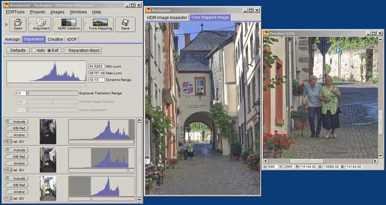

The following example shows how to use the separation sliders. The scene shows a typical use case for this method: separation is easy and effective if the scene is easily separable into several intensity areas and the moving objects are each completely within the respective intensity area. In this case two areas can be distinguished: the sky with the sunlit house walls and the shadowy area where two ladies are walking. Both ladies are complete in the shadowy area.
Defaults
Separated with mask
Separated without mask
  Separation example
'Defaults' shows the 'ghosts' caused by the moving persons. Separation now means to take the light areas from the first image while the shadowy areas - with the ladies - are taken from the second image and evtl. very dark areas from the third image. To accomplish this one simply has to move the slider of the bottom image to the left until the ghost artefacts are gone, see 'Separated without mask'. 'Separated with mask' shows which pixels are adopted from the middle (selected) image. Areas that are not adopted are colored red. The separation mask is a good aid when adjusting the sliders.
This example also reveals a side effect of the separation. The photos were taken freehand and hence are slightly misaligned. The alignment function has corrected the horizontal and vertical shift but more complex contributions like rotation etc. have not been corrected. This can be seen when toggling between 'Defaults' and 'Separated without mask': the buildings move slightly between the two views. Here the separation reduces visible seams because seams form only along the separation boundaries. This positive trait often hides 'slight jitters' or at least makes them less noticeable.

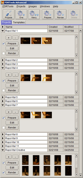

  Project consisting of 11 exposure series
In the following example an object is illuminated from different directions. For each of the directions a HDR image is created and these HDRs are then merged with the Creative method. The result shows an object that acts quite 3-dimensional and does not cast shadows though it obviously has been illuminated.
The figure to the left shows the project. The object (a cooking oil bottle) is spot-illuminated from on high. The spot is then moved around the object in steps and an exposure series +2, 0, -2 EV is taken at each position. Then a HDR image is created from each of the exposure series. Thus 11 HDR images are produced in total, see the projects RapsVital 1 to RapsVital 11. The figure exemplarily shows the images for three of the eleven positions.
The HDR images of the several positions are now combined to the new project RapsVital Creative. The project is opened with the editor and the Creative method is chosen for HDR creation. The intensity curve is adapted as shown in order to remove remains of shadows. Changes to other parameters are not necessary. Finally the image is tone mapped with the Compressor method and the result is saved.

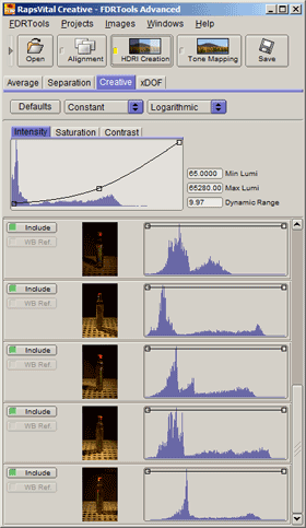

  The Creative dialog
In principle Creative is used like methods Average and Separation. Controls and buttons impacting all images are located in the upper part of the dialog:
Button 'Defaults'
Menu 'Histogram scaling'
The scaling of layer histograms can be 'linear' or 'logarithmic'.
Sliders 'Intensity', 'Saturation', 'Contrast'
When merging the source images the attributes 'Intensity', 'Saturation' and 'Contrast' are weighted for each pixel in order to form the resulting image. A curve is used to adjust the weighting values. The example shows the weighting curve for 'Intensity'. It is adjusted in order to assign a low weight to the shadows and higher weights with growing intensity. Such a curve prefers highlights while shadows are suppressed. The parameters 'Saturation' and 'Contrast' are adjusted analogous via a curve.
The browser below lists the source images as layers. The following parameters steer the influence of a layer on the result:
Switch 'Include'
Switch 'WA Ref.'
Not implemented yet.
Weighting of the intensity is adjustable per layer. The form of the curve can be adapted by adding/removing and moving knots. The resulting weight is equal to the sum of the weights of each layer, multiplied with the global intensity weighting value (see above).

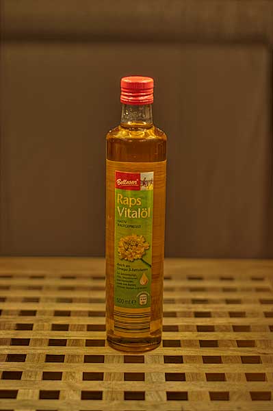

The figure to the left shows the resulting image compared to one of the original positions.
(Both images were created with the Compressor tone mapper and then slightly postprocessed in an image editing application: curve and sharpening).
When looking at the image emanating from the migratory light source one notices that the object does not cast a shadow. That looks strange because the object was obviously illuminated as the traces of the spot light at the bottleneck and the closure show.
The direct comparison to the 'normal' image - shot with stationary light source - shows some differences. The regions lit by the spot are especially bright and hence contrasty while contours lying in the shadow are dark and hard to recognize. The migratory light source in contrast illuminates all contours of the object and makes them clearly visible. This makes the object look '3-dimensional'.
Differences in the footprint can be noticed just as clear. Illuminated from one direction the footprint appears unfamiliar while with illumation from all sides the structure emerges very clear.
The object is clearly silhouetted against background and footprint and seems to 'levitate'. This effect is exaggerated by choosing a large aperture (2.0).
