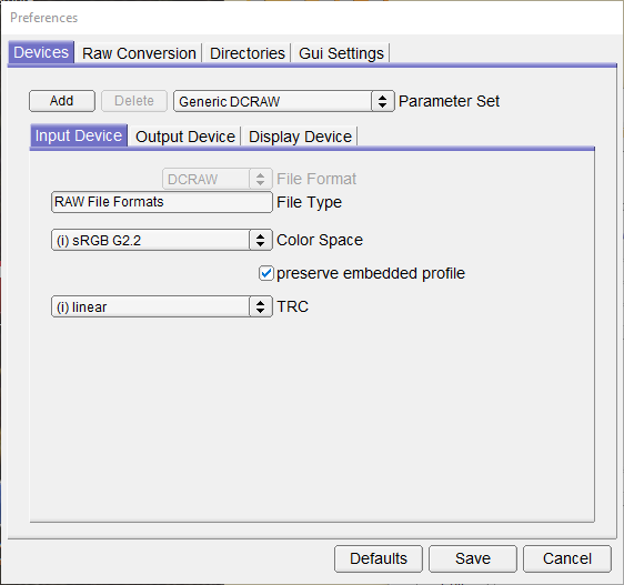

Input Device
  Dialog Input Device
File Format
File format (RAW, JPEG etc.) delivered by the Input Device.
File Type
A textual description of the File Format.
Color Space
Describes the color space of the Input Device. Choices are the ICC profiles that FDRTools finds in the directory configured at ICC profiles directory.
preserve embedded profile
The value configured at 'Color Space' is overridden if a color space - in the form of an ICC profile - is embedded in the image file.
Note: for RAW image files this parameter has a special meaning: since RAW files have no ICC profile embedded one could think that the preserve embedded profile parameter has no effect. However, FDRTools relies on dcraw (a well known RAW converter) to decode RAW files and to convert the image data from the native color space to a usable RGB color space. This color space is adjustable and it was decided to use WideGamut RGB. In addition it was decided that this color space, namely WideGamut RGB, shall be considered the "embedded" color space of a RAW file. This definition is of course somewhat arbitrary but nevertheless makes sense. The bottom line is: activating the preserve embedded profile parameter means that the converted RAW image will be in WideGamut RGB space.
TRC
FDRTools supports measuring the 'Transfer Response Curve' of the input device. Such TRCs are contained in ICC profiles also but these are quite imprecise and not suited for accurate linearisation of image data. In order to get properly linearised image data for further processing in FDRTools measuring the TRC is reasonable.
Notes:

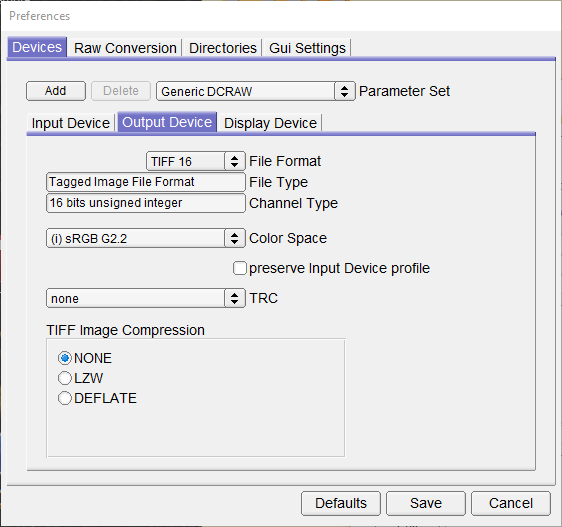

Output Device
  Dialog Output Device
File Format
File format of the tone mapped image.
File Type
Channel Type
A textual description of the channel type.
Color Space
Describes the color space of the tone mapped image. Choices are the ICC profiles that FDRTools finds in the folder configured at ICC Profiles Directory.
preserve Input Device profile
The tone mapped image is not saved in the color space configured at Color Space. Instead the color space configured at Input Device is adopted.
Note: be aware of the special meaning that activating this parameter has for RAW images if Input Device -> preserve embedded profile is also activated, see explanation above!
TRC
Notes:
Image Compression
A compression scheme supported by the selected file format.

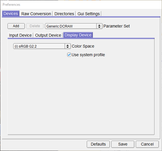

Display Device
  Dialog Display Device
Color Space
Describes the color space of the display device.
Use system profile
Use the system display profile (if available). This overrides the manually configured profile above.

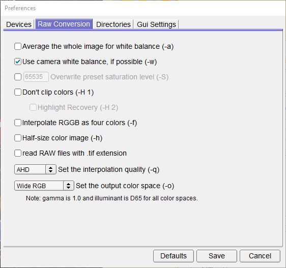

Raw Conversion
  Dialog Raw Conversion
Average the whole image for white balance
Calculates the white balance correction factors by averaging the whole image. In general this method is not recommended.
Use camera white balance, if possible
Utilizes the values calculated by the camera, if available.
Overwrite preset saturation level
DCRAW has internal presets for the overexposure limits. Beyond these values a color channel is regarded "saturated".
In general the preset values are right. However, certain camera models seem to show a strong variation of the saturation levels among individual cameras. One example is the Canon 40D. If the true saturation value of the camera is below the preset value this results in "pink colored highlights". In this case the saturation value can be lowered manually until the pink highlights disappear. More information is available from Guillermo Luijk .
Don't clip colors
Usually the highlights are clipped to the saturation value. This can be switched off. This normally results in pink colored highlights, see also FAQ.
Highlight Recovery
With unclipped highlights it is possible to recover details from useable information within the unsaturated red channel. This method makes sense only in case of an emergency, e.g. if only a single RAW image is available. An exposure series is always preferable and yields optimal quality.
Interpolate RGGB as four colors
This option is required by certain camera models.
Half-size color image
Four pixels are combined into one. This results in an image of half width and height, accelerating RAW decoding and further processing within FDRTools.
read RAW files with .tif extension
CAUTION: this option adds TIFF to the list of file extensions recognized by DCRAW. Do not check this unless your camera produces RAW files with .tif extension like the Canon 1Ds. Reading 'normal' TIFFs with this option enabled may yield unexpected results!
Set the interpolation quality
Set the output color space
During "development" RAW images are converted from a camera specific color space to a device independent color space. Set this color space here. The default value is "Wide Gamut RGB".

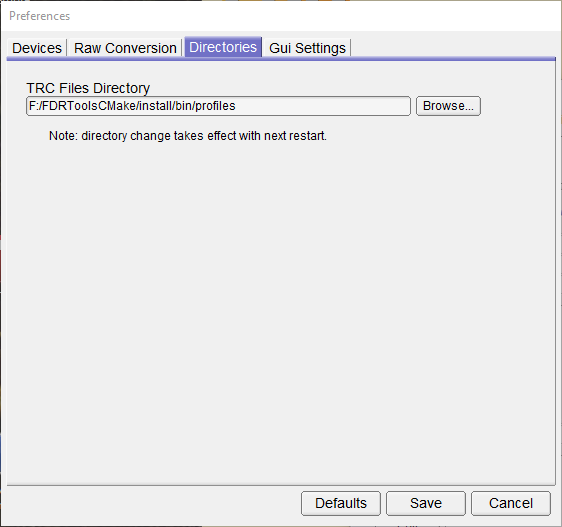

Directories
  Dialog Directories
TRC Files directory
FDRTools looks this directory for TRC files.

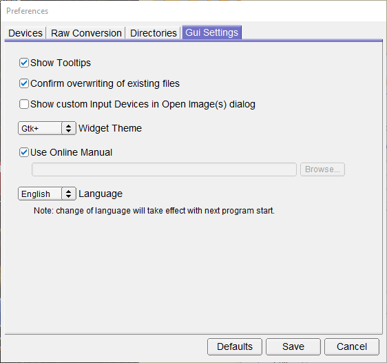

Gui Settings
  Dialog Gui Settings
Show Tooltips
Show a help text if the mouse is moved over a Gui element.
Confirm overwriting of existing files
Protects against unintended overwriting when saving an image.
Show custom Input Devices in Open Image(s) dialog
This switch activates the use of custom Parameter Sets within the file choosing dialog.
Widget Theme
The look of the Gui elements can be adjusted via "themes".
Use Online Manual
With active switch the program uses the online HTML manual from the FDRTools website. If you wish to read "offline" you may also use a HTML manual that is saved locally on your computer. Note that the HTML manual is not part of the software. If you want to use this option go to download pages of the FDRTools web site, load the HTML manual (ZIP archive) down to your computer, unpack the archive somewhere on your computer and navigate to this place via the "Browse..." button.
Language
Sets the language used to display texts in the program. Changing the language setting will take effect with the next program start. The default language is taken from operating system settings.
